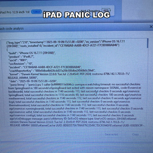

Apple iPad Pro 12.9-inch (A1584) intermittently reboots every 10–15 seconds. When connected to diagnostics tools, the panic log reports consistent watchdog resets caused by SpringBoard failing to check in.
iPad Pro 12.9" 1st Gen - Panic Log

  • Panic log contains repeated lines such as:
    • “userspace watchdog timeout: no successful checkins from SpringBoard”
    • “SpringBoard last successful checkin: 0 seconds ago”
  • System may show additional services not checking in (backboardd, mediaserverd, wifid), which is normal when SpringBoard fails first.

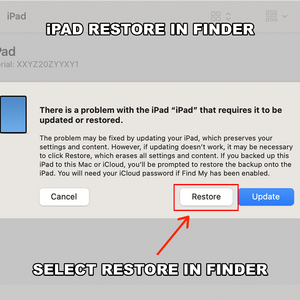

Select Restore Option in Finder

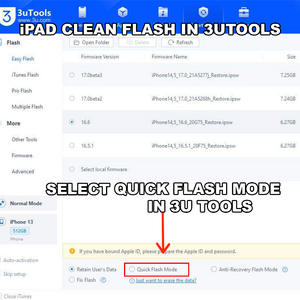

Select Clean Flash in 3UTools

1. Read Panic Log
Open the panic log from the iPad or using 3UTools:
Look for:
  • userspace watchdog timeout
  • no successful checkins from SpringBoard
  • last successful checkin: 0 seconds
Interpretation:
This is almost always a software-layer failure, not a hardware issue. SpringBoard isn’t responding, so watchdog forces a reboot.

3. Perform Clean Flash
Use:
  • Apple Configurator / Finder
  • 3uTools, etc.
Select Clean Flash in 3UTools and Restore in Finder so system partitions fully rewrite.

  2. DOWNLOAD Load IPSW Firmware
    • Choose latest signed IPSW for A1584 FROM IPSW.ME
    • Select Restore on Finder (not Update) & Clean flash on 3UTools
  3. Erase & Flash
    • Allow full system erase
