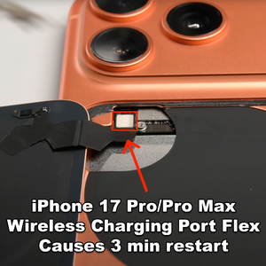

  • Wireless Charging Flex - The flex that's attached to the back glass. It must be plugged in & not damaged, otherwise it will restart every 3 minutes

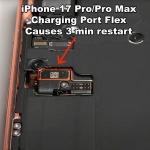

  • Charging Port Flex - This is the flex towards the bottom of the phone. It is easily damaged by water/drops or when someone has replaced the port with a bad/aftermarket one.

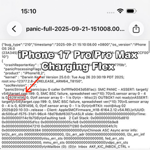

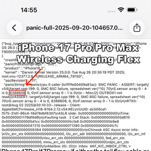

Before you start blindly replacing parts, it's important to try to confirm what is causing the restarting issue by reviewing the Panic Log file. This is a file that is generated by the Operating System, to document the fault causing the restart.
To find the panic log on the device, go to Settings-> Privacy-> Analytics & Improvements-> Analytics Data-> Scroll down to the files starting with "panic-full..." & click on the most recent dated file. Then you'll want to scan through the text for keywords that may point you to the cause.
For this model, look for where it says "SMC PANIC - ASSERTION FAILED" ... "Sensor Array" .. "23...."
If you see:
iPhone 17 Pro/Pro Max Charge Port - Panic [Fig. 4]
  • 8388608 [0x800000] - it's the Wireless Charging Flex (Back Glass) [Fig 5]
    • Make sure it's plugged in & the flex is not torn
    • Check that there's no liquid damaged, or that it's defective
    • Test with OEM or Premium. Aftermarket Flexes have a high defect rate
    • Diode mode the FPC connectors for any faults
  • 6291456 [0x600000] - it's the Charging Port Flex [Fig 4]
    • Make sure this flex is plugged in
    • Make sure the Air Pressure Sensor is plugged in
    • Check that no flex is torn, liquid damaged, defective
    • Test with OEM or Premium. Aftermarket parts have a high defect rate

When trying to solve for these issues, make sure to replace the appropriate flex with an OEM or Premium flex.
It is also a good idea to keep a known good power button flex & charging port flex in your bench, for testing only. There are reports of even NEW flexes being bad. So you have to keep known good flexes on hand at all times, so you don't waste your time troubleshooting with possibly bad flexes.
In scenarios where you have the appropriate flexes plugged in, but it still restarts, then you either have:
  • Bad or damaged flex
  • Low quality aftermarket flex
  • Other flex cables that are Liquid Damaged
Please note: You MUST have the required flex cables plugged in. Otherwise, it WILL restart. You cannot troubleshoot this step by unplugging the bad flex.
