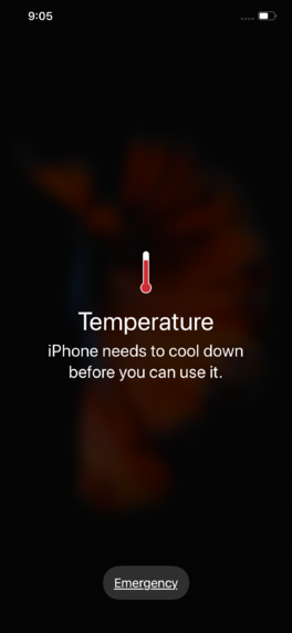

Problem description
iPhone 14 shows temperature warning when powered on. Device charges normally while powered off but does not charge when turned on. Severe overheating occurs once the phone boots.
Symptoms
  • Temperature warning appears after boot.
  • Phone charges when powered off, but not when powered on.
  • Device overheats rapidly while powered on.

    Figure 1 - Example of Temperature warning on iPhone
