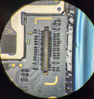

Repair Steps
If you have 2A current draw on the DC Power Supply before you prompt to boot, then you'll want to check for shorts on ____
Use a thermal camera or freeze spray to track down the short Example image etc.
