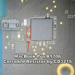

A MacBook Pro A1706 (13-inch, Touch Bar) presents 5V and power cycling only on USB-C after liquid exposure near the CD3215 USB-C controller area.
On inspection, resistors near the CD3215 IC are found corroded, interrupting the communication and power negotiation process between the logic board and the charger.
MacBook Pro - A1706 Corroded Resistor near CD3215

  • Visible corrosion around CD3215 IC.

  1. Clean the Area
  • Remove conformal coating and corrosion with IPA and soft brush.
  • If pads are damaged, repair traces under microscope.
2. Replace Faulty Resistors
  • Identify corroded resistors (commonly R3108–R3109 or nearby on CD3215 lines).
  • Replace with correct values per schematic (typically 1 depending on the line).
