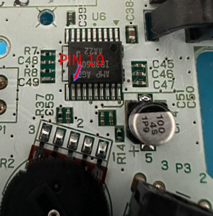

The next thing to check is if the volume potenciometer is working properly
Place your the red probe of your multimeter on PIN 10 of the Chip and move the volume potencimeter the voltage should change from around 0.5V all the way to 3V.
Gameboy audio amp pin 10

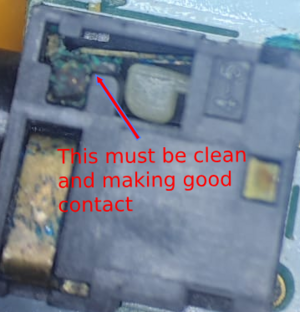

IF audio is only working on Headphones it is possible there is a problem on the audio Jack it is common to have corrosion inside this port.
Corrosion Gameboy Audio Jack

If the voltage is not working properly on PIN 10 the solution is to replace the potentiometer.
If you have corrosion inside the Audio jack clean it as must as possible and be careful not to damage it since this part is really hard to find.
