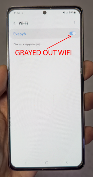

Wi-Fi is not working or cannot be enabled. The device fails to detect or connect to wireless networks despite no visible board damage.
Symptoms

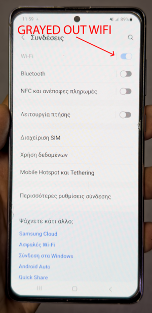

- Unable to turn on wifi
- Stuck on faded blue color(depended on theme of the phone)
- No wifi list showing in the settings
- Bluetooth doesn't turn on aswell

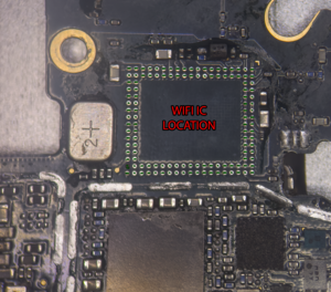

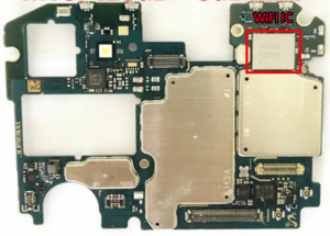

There are three main reasons on this specific device the wifi and the bluetooth stops turning on:
- Cold solder under wfi ic:
- Check for any physical damage near the wifi ic
- Check for shorts near the wifi ic
- Remove the wifi ic
- Check diode value under the wifi ic

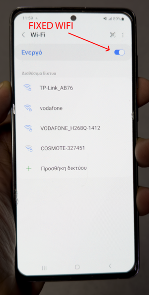

- If all diode readings are normal, reball and resolder the Wi-Fi IC, then test if the issue is resolved.
- Bad Wifi Ic:
- If there is no change after reballing, replace the Wi-Fi IC with a known-good IC from a donor board
- If still doesn't work try to retrace the OL pads to see for any open lines

- Fixed WiFi:
