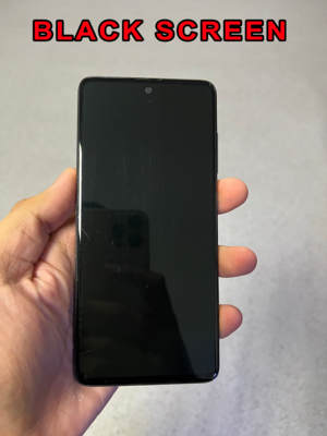

If you receive a device in this condition it will be showing a black screen after the 1st(boot logo)
Symptoms
The symptoms of the device should meet all the symptoms below on order to proceed to repair:
  • Device shows 1st logo(boot logo) and after that screen goes black and stays on black screen forever and does not go to the 2nd logo at all (see the reference pics below)
1st logo
2nd logo
black screen
  • The device does not go the home screen with screen connected(without screen connected the device turns on completely and you can feel the vibrator motor)
  • Phone must NOT bootloop ( shows the samsung logo again and again) and should stay on black screen

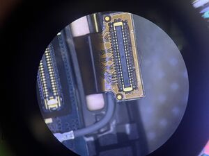

  • Pretin the pads #5 and #7 as shown in the picture
Pretin pad 5 and 7

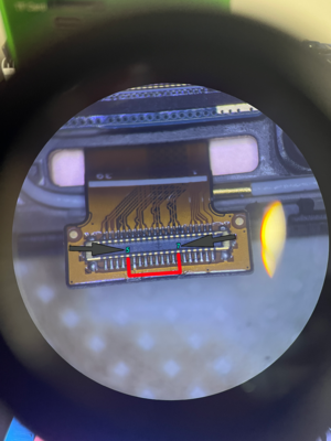

  • Make a jumper on these 2 pads with 0.02mm jumper wire like shown in the pictures below
Jumper pad 5 to 7
The jumper fix
  • Solidify the connection with uv

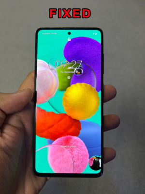

  • Now check, your device should be fixed
Fixed
