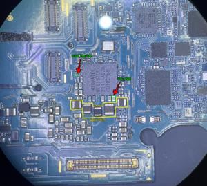

Diagnostic Steps
  • On the wall charger the consumption is under 0.00-0.02 A
  • Check for VPH_PWR if its available and stable(3.6-4.2v)
  • Check buck voltage with charged battery + charger plugged in (if its not stable then you could have this issue)
  • Check VUSB_PMU_CAP diode value to make sure if you have the same exact issue to proceed for repair (should not be 0.000)
    Initial Checking

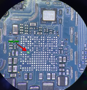

  • Remove the PMIC MT6357CRV
  • Check the pad #J14 (VUSB_PMU) if its shorted after removing the PMIC (if the pad is not shorted after removing the PMIC then just replace the PMIC.)
VUSB_PMU
  • If its still shorted then cover it with some uv mask
  • Reball and reinstall the power ic
  • Your phone should start working again
