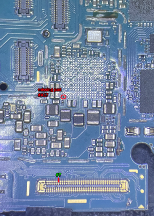

There is a assential voltage for graphics that comes from PMIC that gets disconnected after several drops and the solution for this is that you have to make a small jumper to reconnect the disconnected pad in order to have it fully function again.
Repair Steps

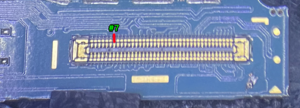

Check Diode value on this pin(if value is OL or high then proceed to the repair steps):
Diode Value
  • Lift up the PMIC
  • Check pad #A17 if its disconnected, if not try to move it and see if it comes off or its lose (shown in picture below)
Example image (Figure 1) -- No image yet. Help expand this page by uploading it!

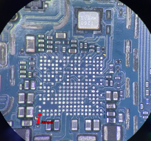

  • Make a jumper for the pad no.17 from the nearest component to the pmic (shown in picture below)
A17 jumper
  • Check continuity, if its ok then gently clean the area and apply uv solder mask
  • Reball and reinstall the power ic
