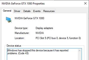

Error 43 on a GTX 1080, or any NVIDIA graphics card, typically indicates a driver-related issue. This error code is a part of the Device Manager in Windows and suggests that the graphics card has been disabled due to a problem. Usually hardware problem. Here you'll find multiple ways to identify the cause and potentially fix it.
![](/images/thumb/a/ac/Gtx_1080_error_43.jpg/300px-Gtx_1080_error_43.jpg)
Symptoms
- Error 43 in Device manager
- Display in low resolution
- Sometimes artifacts on the screen
