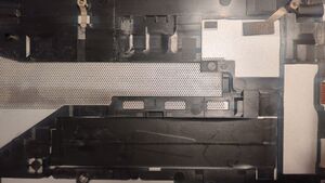

When the laptop is lifted, sitting on an uneven surface, or slight pressure is applied to the back the laptop will either freeze or have a serious kernel error.

Electrical tape added to the back plate where the RAM modules come in contact
The bare metal back plate comes into contact with the RAM modules when pressure is applied to the center of the back of the laptop. I added a bit of electrical tape to insulate the metal from the RAM. Combining this with Elitebook 850 G5 Not turning on, 3.2 boot error I have been able to use two modules of RAM without crashes.
Additionally, I found that flexing the RAM sticks towards the board crashes as well. I added a small dab of hot glue on the middle of the stick to prevent it from bending toward the motherboard.

When the coating of the back plate is scratched, the conductive metal is exposed. I measured a resistance of 0.3 ohms between two scratched points. Additionally, when plugged in to the wall, I measured some amount of 60 Hz AC voltages around the back plate. Adding any insulation will help increase this resistance and I believe there is enough clearance for a small strip of electrical tape.

  3. Place 2 strips of electrical tape on the back plate where the RAM makes contact. See the picture for location.
