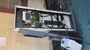

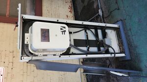

Disassembly to access EVSE internals
  1. Remove two security bolts (Torx security, 4 mm) at top of pedestal.
  2. While lifting LED light assembly up, disconnect the wiring harness, and set the assembly aside.
  3. Remove the two bolts at the top (hex, 10 mm).
  4. At the charging cable management reel on the front of the unit, remove the white cosmetic cover; it pops out with help of a flathead screwdriver.
  5. Remove the two (maybe 3-4) bolts (hex, 10 mm) that hold the reel onto the pedestal. You will need a nut driver for this, since the bolts are recessed in deep holes.
  6. Tilt the large metal cover forward away from the pedestal assembly and lift it away. While you do this, you will need to feed the charging cable back through the grommet. You won't be able to disconnect the cover completely due to the attached cable, but you'll be able to set it aside.
  7. Remove five bolts (hex, 10 mm) that hold the EVSE cover on; these should just be finger tight since they are fastening down plastic.
  8. As you remove the EVSE cover, slowly peel the adhesive gasket off the touch screen.
It's not necessary to access the EVSE internals, but if you want to also remove the pedestal's back cover, use a regular (non-security) Torx T25 wrench. To lift it off the ground mount, you'll need a 1/2-inch box wrench.
Basic preventive maintenance
These action items are based on known problems with how this hardware was originally assembled, and should be performed if you are already opening up the unit.
  • There is a current transformer on the power lines routed at the bottom of the internals. If allowed to drift left, this can pick up noise from (or generate noise to?) an adjacent component, disrupting operation. Therefore, gently push this CT to the right, so that it's next to the choke that's adjacent on the line.
  • Check the power terminal for stray wire strands. Some of the strands may not be captured inside the terminal blocks, and may lead to shorts. If found, remove and reinstall the wires.
See below for more significant rework procedures.

PE-30 touchscreen assembly
  1. Open up the pedestal per the steps above.
  2. Look behind the touchscreen. Immediately behind it will be a PCB that drives the touchscreen (and the RFID sensor mounted below it). Behind that, about 300 mm further "back" and mounted on plastic standoffs, is another PCB which is a small Linux computer to drive the network connectivity.
  3. PE-30 touchscreen power disconnected
    Just below the bottom of the touchscreen is a three-pin interface with three thicker blue wires going to it. This is providing power to one of the PCBs. Disconnect this. The photo here shows what it looks like after it's been disconnected.
  4. PE-30 touchscreen data disconnected
    On the top edge of the computer PCB is a 10-pin interface with many thin blue wires going to it. This is providing data between the computer and the touchscreen. Disconnect this. The photo here shows what it looks like after it's been disconnected.
After performing this surgery and putting the unit back together, it is recommended that you remove any Blink branding -- most of it is just vinyl lettering that you can peel off, but some is embossed in the plastic and should be taped over. You should also tape over the touchscreen, perhaps with a sign saying "just plug in" and a mention of the host business that is generously giving away the free charging.
