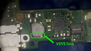

For this guide we will be testing without a battery and we will be bypassing the temp sensor by using a 10k resistor between the battery test pads next to the battery connector. Our bench power supply will be set to 4.2v at 2a (this is important as less than 2a will fail to reach second stage boot) and we will be powering via the VBAT test pad of the BQ24193 (Unless testing VSYS line for first stage boot).
First Stage Boot Checks - *THIS IS THE ONLY TIME WE ARE USING VSYS INSTEAD OF VBAT* Reduce amps to 1a, 4.2v on the VSYS line preferbly on the bottom side of the coil located next to BQ24193. If you have no short (max amps) then you are good to move forward and test the VCORE rails surrounding MAX77620 and the 3.3v regulator marked (EN--) above the audio ic. If you have short on the 3.3v rail move on and check M92T and P13USB etc. Next click and hold power button to turn on, watch the draw on bench power supply it should be around 195ma, but if you are getting the lower end of around 100-130ma then you could be looking at MAX77621 or MAX77812. If you have NO draw then you are most likely looking at MAX77620.
