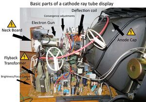

CRT (cathode ray tube) are found on older televisions, monitors, and other equipment.
![Inside of CRT television with basic components labelled.](/images/thumb/f/f1/517px-CRT_diagram.jpg/300px-517px-CRT_diagram.jpg)
Safety Warning:
CRT displays contain extremely high voltage (up to 30,000v!) and the acts as a capacitor which can store a lethal charge for weeks after the display has been unplugged. The tube MUST be discharged properly before performing any kind of internal repairs.
Here is a good guide to refer to for discharging CRTs: https://www.youtube.com/watch?v=1CVXzlkOjGg
CRTs also contain mains voltage so general electrical safety precautions should be taken when working on them.

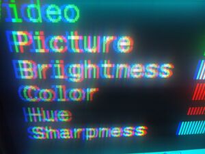

Misconvergence, one colour sticks out from the rest on edges between light and dark, or in extreme cases the colours have completely separated from each other. | Information coming soon |
