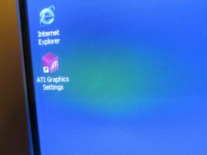

Magnet damage, screen is badly distorted in colour and/or geometry. "Magnet damage" in this case refers to when the internal parts of the tube have been affected by a magnet being brought near then which messes up a bunch of things and may make the display seem unusable, however it can sometimes be fixed (depending on severity.) The display needs to be degaussed there are 2 main ways to do this.
  • Using the internal degaussing function: More modern CRT displays will often contain some for on an internal degaussing coil that can be activated from the OSD controls. On monitors it can be found in the user settings or even as a discrete button, the symbol for a degauss button/function is a horseshoe magnet with a cross through it. In TVs it may need to be accessed through a service menu or a service remote, refer to your TV's service manual to see how to access it. Run a single degauss, if it does not fix the problem the wait a few minuets and then degauss again, if it still does not help or does not fully restore the screen then move on to the second method.
  • Using an external degaussing tool: An external degauss coil will be more powerful and effective than the internal function. To do this you will need either a degaussing coil (which can be purchased on eBay) or a strong neodymium magnet. For a degauss coil you simply hold the coil to the screen, turn it on, then slowly pull it away from the screen. To degauss with a neodynium magnet you hold the magnet up the screen then spin the magnet while slowly pulling it away from the screen.
