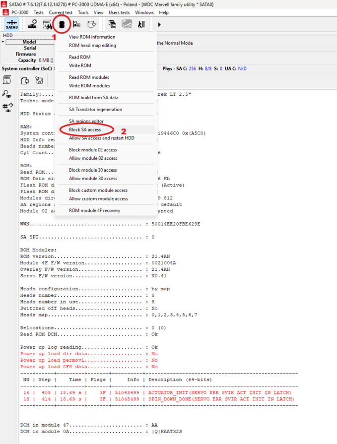

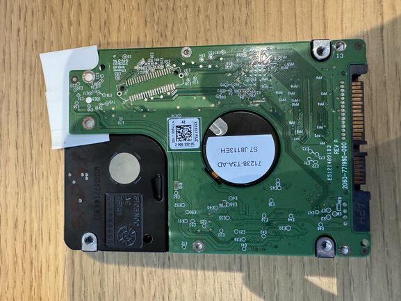

1.) Separation of the head stack assembly from the PCB to gain access to Kernel mode.
2.) Block the Service Area access

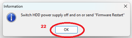

3.) Power the drive off, remove the isolation and screw the PCB in
4.) Power the drive on

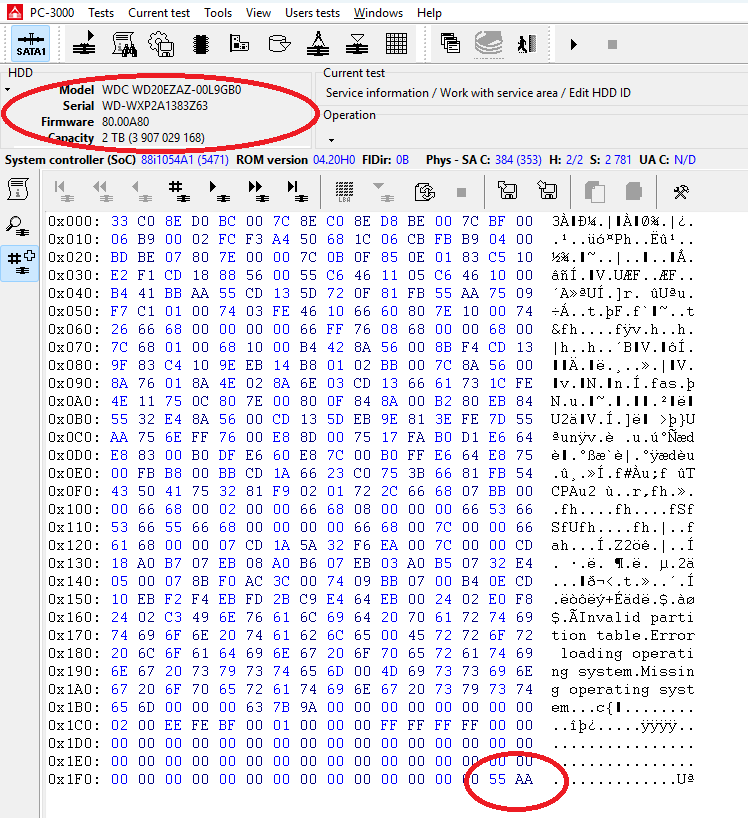

6.) Like you can see the ID of the drive is wrong. You need to sent the DIR and module 02 in the HDDs RAM
7.) In the case of CMR drive we can upload those files from the HDD Service Area (SA)
8.) After this the ID of the drive change to SN#XYZ--- At this step you should have an access to the SA and make a backup of it

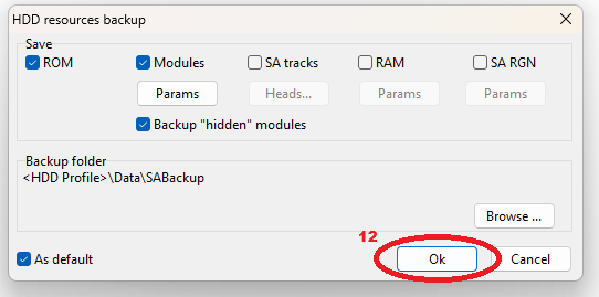

9.) Choose or create a new profile and hit OK

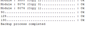

Here the backup of the SA modules begins

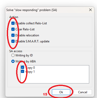

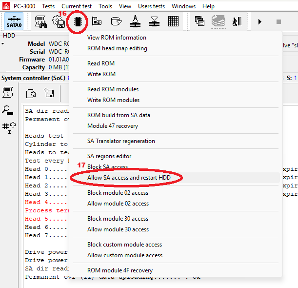

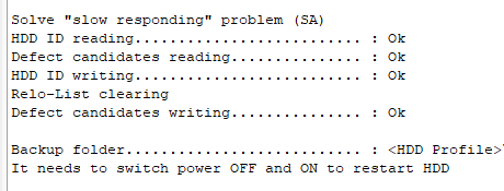

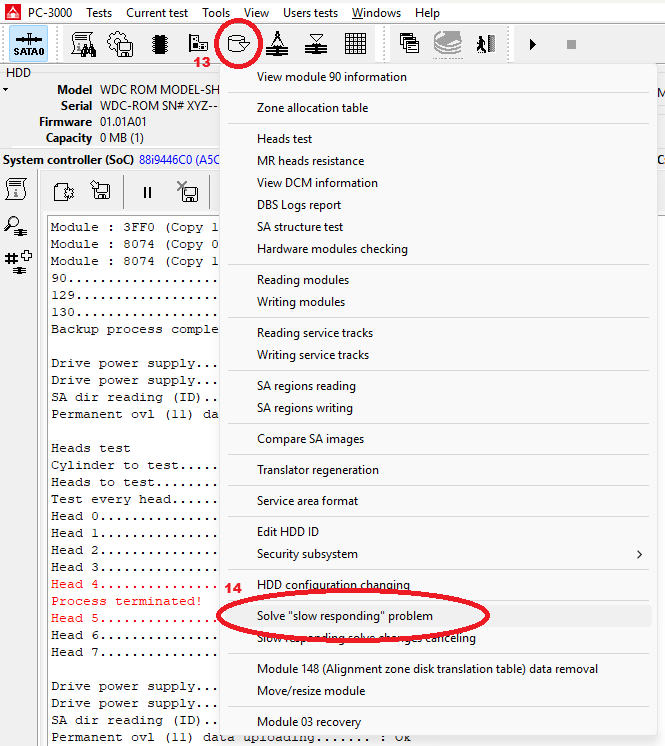

10.) If you don’t have any issues with the modules you can go to do:
11.) Now you can allow the Service Area access and restart the drive

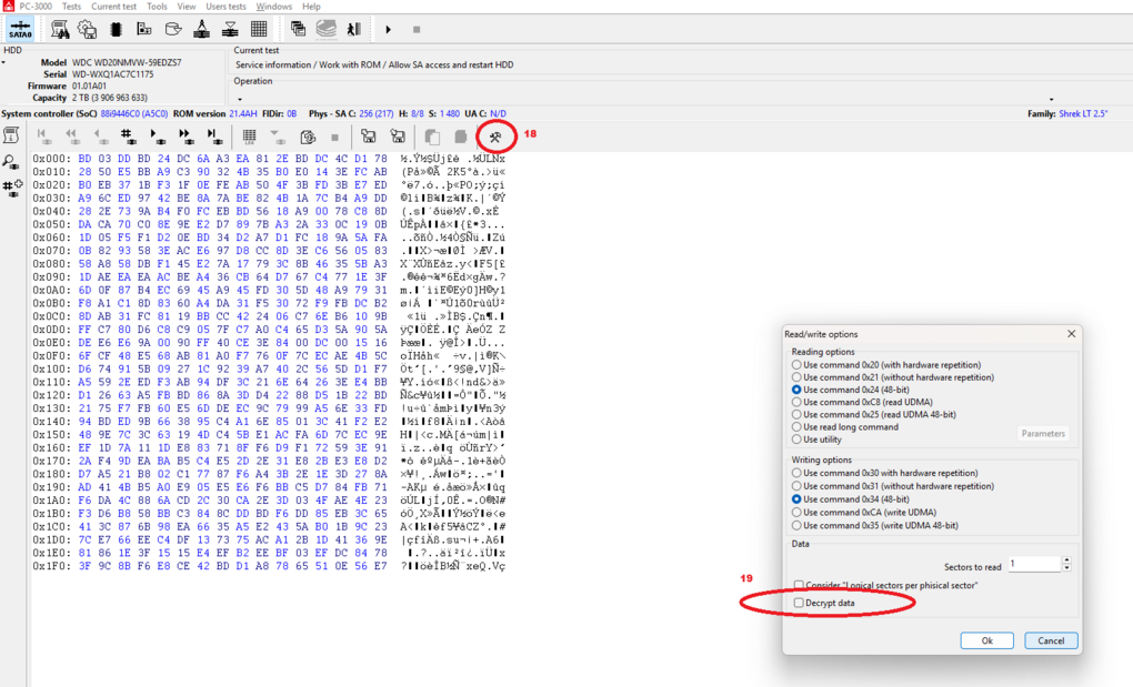

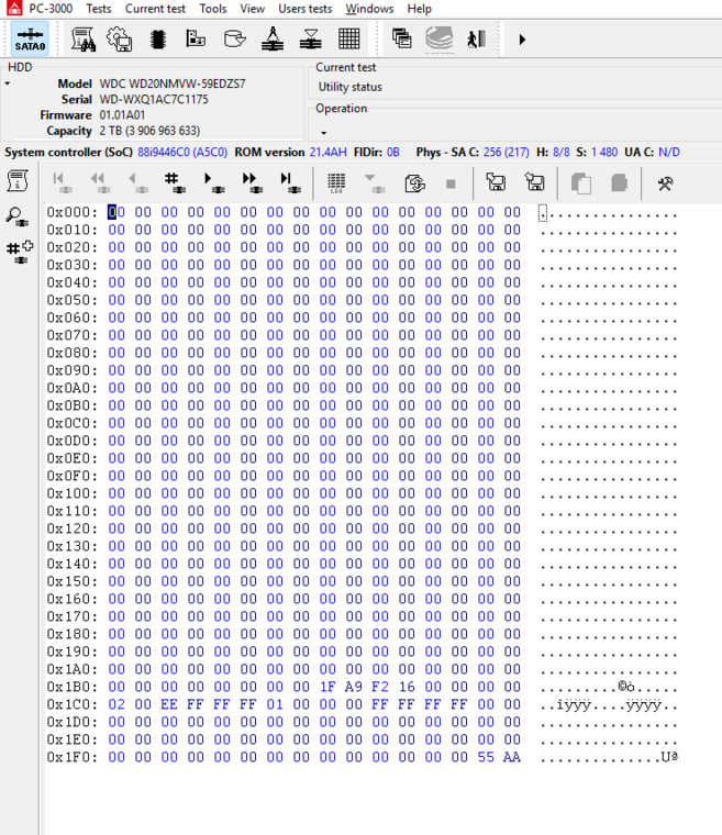

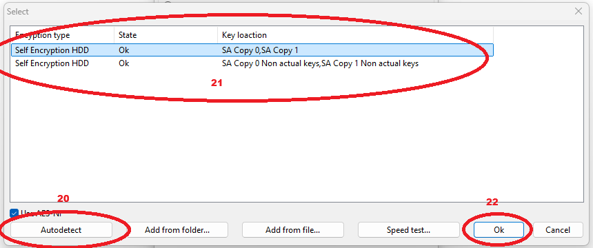

12.) There is only one step to do, we need to check if the data is encrypted. After restarting the drive go to the Sector Edit (ALT+V) and check sector 0. If you see something like this it means the data is encrypted by the HDD firmware
13.) Decrypting the data:
14.) When you hit the Autodetect button the software will fine the key in the Service Area
Now you have access to the encrypted data

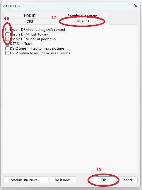

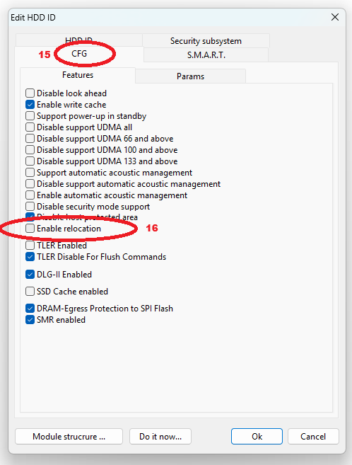

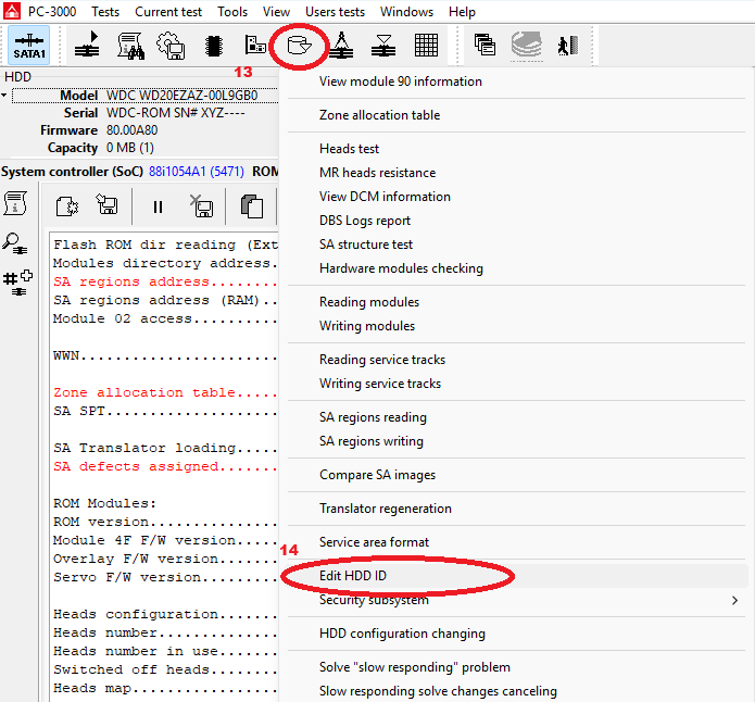

11.) After the modules backup, instead of “Slow slow responding problem” solution in the “Work with service area” drop down menu hit “Edit HDD ID”
12.) Click CFG tab and turn off the relocation
13.) Go to SMART tab and turn DRM off and click OK

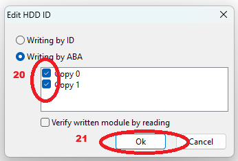

14.) Save changes to the both copies and restart the drive

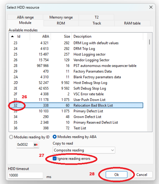

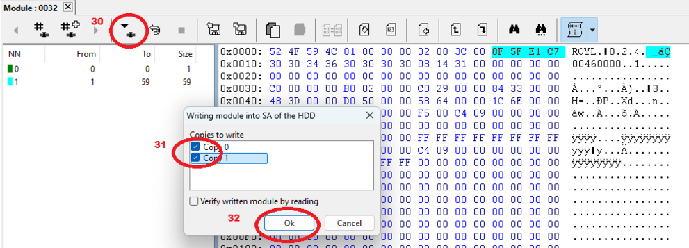

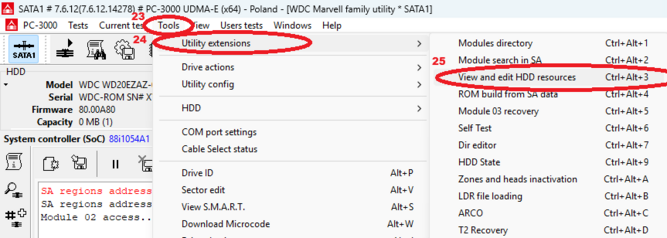

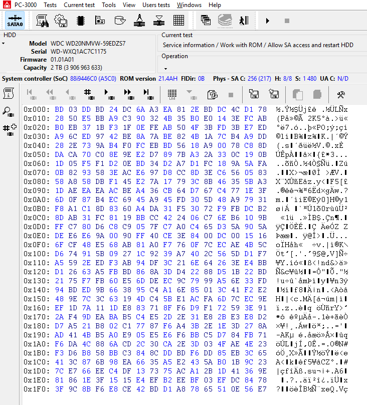

15.) Now we need to clear the Relo-list. Go to Tools -> Utility extensions -> View and Edit HDD resources or you can use Ctrl+Alt+3
16.) Find module 32 and read it

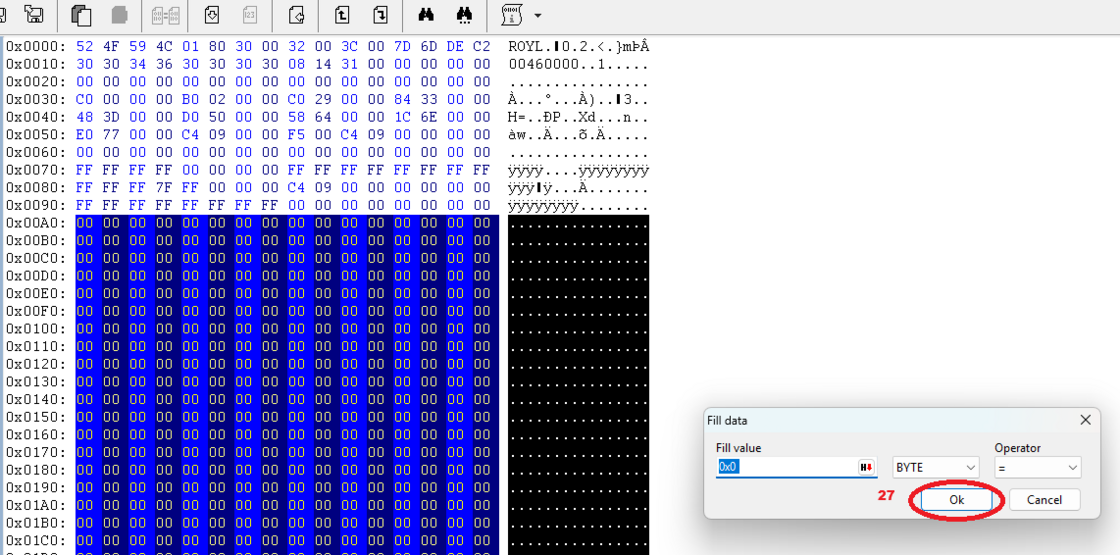

17.) Now the PRO tip is coming, select the HEX values from the address 0x00A0 to the end of the module hit Ctrl+d and fill that area with 0x0

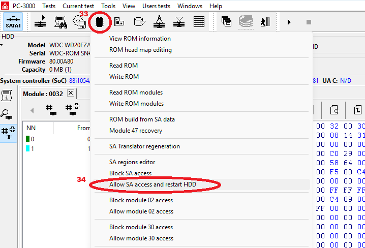

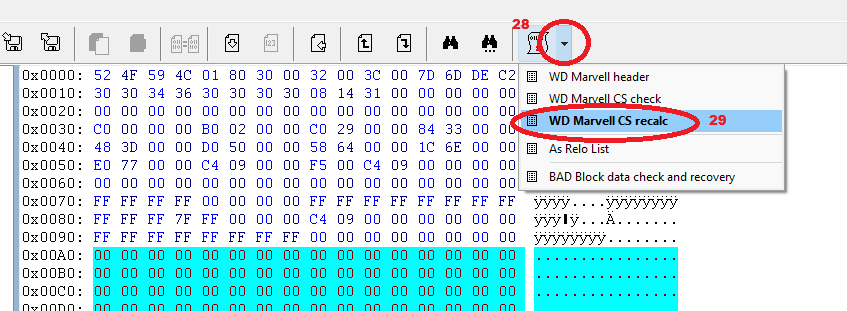

18.) Now you need to recalculate the checksum
19.) Write back corrected module to the HDD
20.) Now you can allow SA access and check if the data is accessible
Like you can see the drive has correct ID and you have access to the customer’s data.
