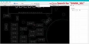

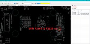

- Search in Nets box for "DIMM_SEL" string.
This will list all RAM configuration lines, DIMM_SEL1-3. Initial RAM configuration is 101; RAM slot plus onboard RAM available.
See Fig.1.

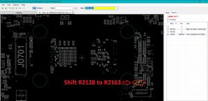

- Locate DIMM_SEL1 and corresponding resistors.
Shift R2128 to R2163.
See Fig. 2.
- Locate DIMM_SEL2 and corresponding resistors.
Shift R2165 to R2169.
See Fig. 3.

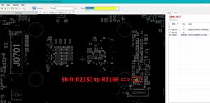

- Locate DIMM_SEL3 and corresponding resistors.
Shift R2130 to R2166.
See Fig. 4.
The final RAM configuration will be 010; only RAM slot available.
