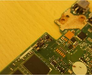

Repairing a water damaged L406M laptop.
![](/images/thumb/7/76/Asus_L406M.jpg/300px-Asus_L406M.jpg)

- the most damage was done in the area marked J5601 on the board.
- some contacts of resistors and other chips were corroded there.
- after repairing the contact to the board via soldering, the machine started.
