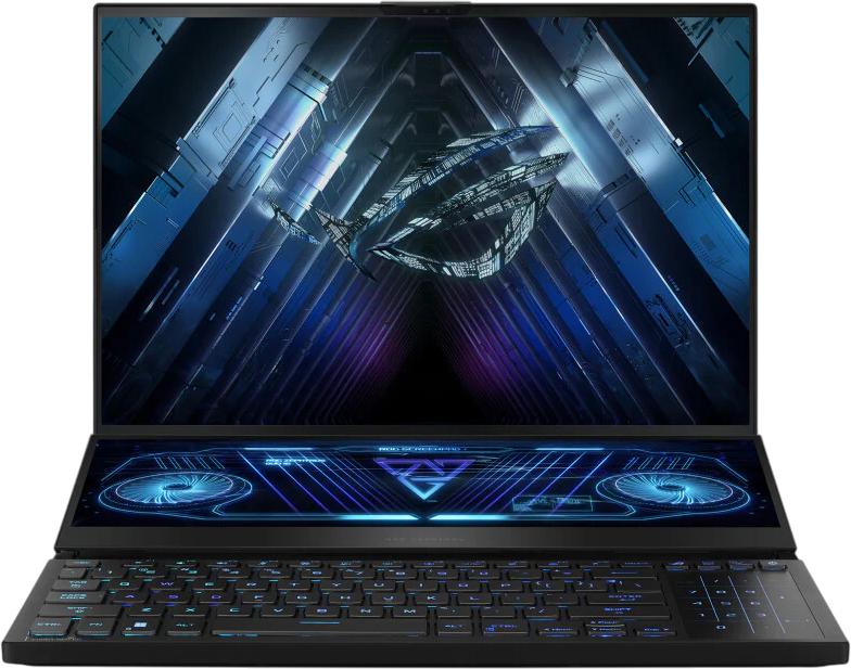

Device pictures
A render of the ASUS GX650P with the background removed.

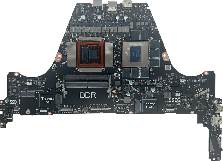

PCB pictures
A view of the front of the ASUS GX650PY's motherboard. A view of the back of the ASUS GX650PY's motherboard. Most of the motherboard is covered by mylar tape and not visible.

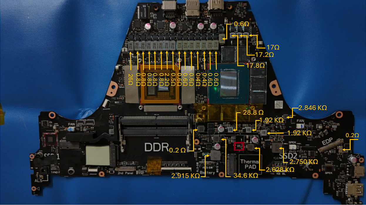

Reference measurements (also schematics if available)
Resistance measurements of the inductors soldered to the front of the ASUS GX650PY's motherboard.
