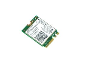

WiFi toggle gets stuck in off position and wireless connectivity fails.
The wireless card will look like this.
Symptoms
  • Not able to connect to wifi
Solution
After removing the bottom panel, unscrew the wireless card and pull it from the socket. Use rubbing alcohol to clean the contacts on the card and let it dry. Reinsert the WiFi card and boot the device, then test wireless connectivity.
