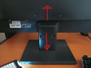

  3. Pull the monitor off its stand. It slides out with some effort.
    Simply pull the base down and the screen up

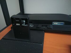

    The stand after removal

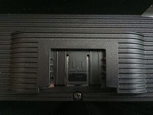

  4. In the space where the stand was connected, there will be a single screw, remove this screw.
    The screw

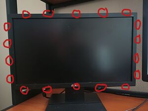

  5. The cover of the monitor is held in by clips. Remove the cover using your pry tool. You can improvise the pry tool with a flathead screwdriver or a butterknife if you're not worried about the case being scratched.
    This is roughly where the clips holding the case together are

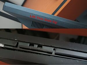

    1. Start at a corner. These are the easiest spots to pull open the case.
    2. The back side of the case has teeth that fit in slots in the front. You'll want to angle your pry tool to lift the teeth out of the slots.
      The back side of the case is towards the bottom for both images
    3. From the corner work your way all around the case

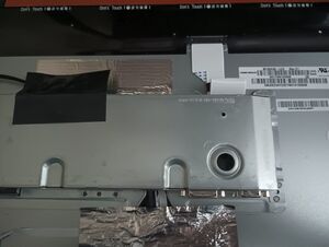

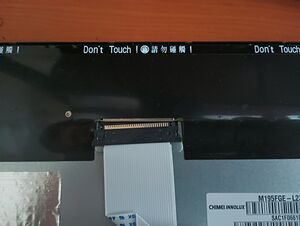

  7. The ribbon cable will have a connection near the top of the monitor. There are very few visible cables. It will be very easy to identify.
    The ribbon cable is in the top right. It is white
  8. If you can see some of the shiny pins of the cable at the connection, it is likely that the cable was loose. Push the connector into the socket to tighten the connection. You might also choose to disconnect the cable and clean out the socket using compressed air before reconnecting it.

    The cable disconnected. You can see the color of the pins here.
