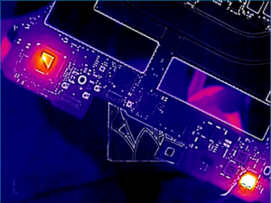

No power, PPBUS_G3H shorted to ground. Inject 1 V (increase if no reaction), watch for hot spots with thermal cam. Usually it's a bad tantalum cap
Example: https://www.youtube.com/watch?v=33M3krGWAOU (board taking 20 V, 20 mA, PPBUS_G3H 0.3 V because of a 56 Ω short to ground)
Measure PPBUS_G3H to vCORE coils (coils around CPU/GPU) IF those measure under 1 Ω (0.3–0.8) then you most likely have a direct 12 V short to CPU/GPU. On this board this situation is always a no-fix.

No power, taking 20 V and 0.014 A, PP1V8_SUS shorted In this case PCH and PMIC to do.
Usually if the board is taking 20 V and 0.01–0.025 A there is a problem with some of the PMIC's voltages. See Fig. 1.
