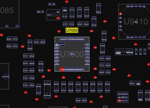

U7000 on a 820-3115 logic board

Normally with this issue the best way to diagnose this is to start backwards so you can isolate your problem, with your multimeter in DC V mode check F7040 for 12.6v on PPBUS_G3H, If this is considerably low or 0v then the issue is isolated to either the circuit that powers U7000 or U7000 itself.
Once you have established that your PPBUS_G3H is low or nonexistent we can move on to checking your DCIN circuit. Check F6905 ensure it is continuous and not blown, we will assume here you are getting 16.5v on F6905 as you should have checked your DC-In board and charger by this point.
Now check to see if you have PP3V42_G3H on R7012. If PP3V42_G3H is present but PPBUS_G3H is not, U7000 is the issue.
There's a few more steps you can do, if you think the issue isn't U7000 follow the schematic on page 3 to try and find your issue, I cannot provide you with board views or schematics but they are very easy to find. Also if your PPBUS_G3H is 12.6v it's not U7000, I have once seen this be a short elsewhere on the board but it's quite rare in my experience and I cannot possibly cover or even know from the top of my head every little thing that could cause this but 99% of the time this issue is U7000.

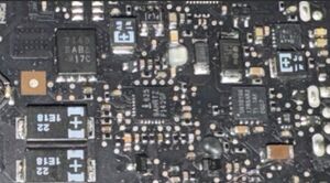

Step 4) Solder the new IC on!
Incase you forget which way the Intersil logo points on U7000 once you have removed it and you have no other A1278's to compare with, I included a picture! :) (Don't bully me I actually had a complete brain fart and did this once years ago, fun times!) the i faces towards the RAM slots!
It's as simple as place the chip over the pads. align it so that you can see a very small amount of the little pads on all 4 corners, make sure it's aligned and flow the solder with hot air while lightly but firmly pressing the IC down with your tweezers until you feel it's aligned and the solder is completely molten. Then remove the hot air and hold the chip down for a few more seconds (moving your tweezers straight away is a novice mistake haha)
Clean up any blobs that may squeeze out the sides of the IC with your soldering iron and some more fresh flux! (If you have a micro pencil like a FM-2032 and a knife tip it's amazing for this).
