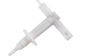

This TV and and many samsung TVs are screw less so you need a special tool to open it (BN81-14946B)
This tool can be found on many websites on online.
Special tool used to open samsung TVs
The are 2 holes on the bottow side of the tv insert the tool like in the image bellow.

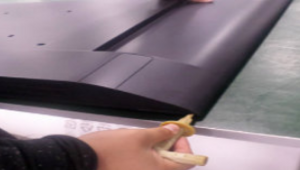

You will see that the plastic cover will pop then start going around the TV like this.
Going around the TV
After going around all the plastic it will come loose simply lift it and put it a side.

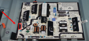

The first step is to understand if the problem is on the main board or the Power supply, to do this we will disconect the cable that goes from the PSU to the main board.
Cable to disconnect
After disconnecting this cable plug the tv into the wall if the backlight of the TV turns on it means that issue is on the main board, if the backlight does not turn it means there is an issue with the PSU.

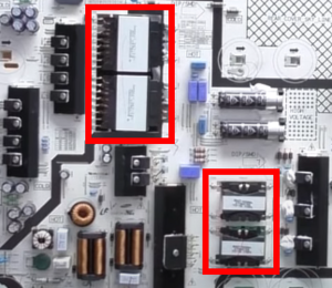

If the fuse is good (most likely will be) the next step is to inpect the solder joints of these components this is the number one fault on this model.
Component to Check

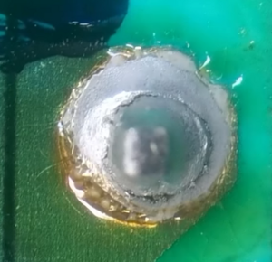

Use a microscope to inspect the solder joints of every pin it is common to have cracks like the image bellow.
Craked Solder joint

To repair the broken solder join:
Start by applying flux and low melt solder with your soldering iron then use solder with to clean the solder.
After cleaning the old solder clean the PCB with a q-tip and isopropyl alcohol.
Apply fresh flux and use a good solder to solder the pin to the PCB.
This process is recomended for every pin of these components not just the one with the broken connection.
