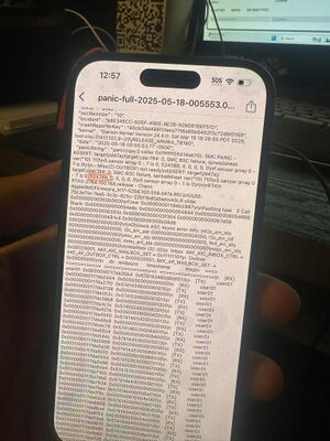

HOW TO CHECK PANIC LOG:
As soon as your phone boots up, immediately navigate to settings > privacy & security > analytics > analytic data
when you get here you’ll be presented with a bunch of reports. Don’t be overwhelmed, simply scroll down until you see the keyword “PANIC FULL”
there might be several. Look at the title for a date.
find the latest one and open it.
below I attached a photo highlighting what the “trigger code” is.
TRIGGER CODE: 524288
CHARGING PORT FLEX ISSUE
SOLUTION: REPLACE WITH ORIGINAL PULL PART.
IMPORTANT!! AIR SENSOR MUST BE PLUGGED IN TO STOP THE REBOOT. IF REBOOT PERSIST REPLACE AIR SENSOR
IF IT STILL PERSISTS , CHECK FPC CONNECTOR PINS FOR ANY SHORTS.
Keep in mind: partially unplugged charging flex can trigger reboot, check carefully no debree or small damage exists in the charging port FPC.
a simple replacement fixes this issue.
