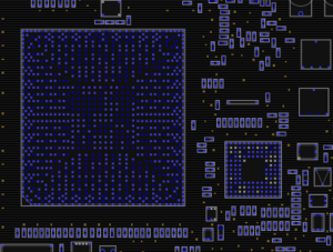

2010 820-2850 or 2010 820-2849 missing PM_SLP_S4_L and therefore doesn't boot.
PCH (U1800) and SMC (U4900) on a 820-2850

So a pretty quick way to do so is to test for SMC_ADAPTOR_EN without the battery connected, this can be checked at R5085 (top side), it should be 3.42V, this signal act's as your high low high pulse that PM_PWNBTN_L would normally create when you push the power button in the case you boot with no battery. This signal tells the PCH that you want to turn the device on so without it, you won't get PM_SLP_S4_L. If the board does boot with no battery off adaptor only and power button does nothing on a good keyboard, it's likely related to this SMC issue. If you are missing SMC_ADAPTOR_EN, shotgun replace Q7920 and R5085 and hope that changes, in this case you are more prone to having crap under the SMC causing this or cracked solder balls on the SMC from a drop, you can attempt to reflow the SMC and hope this issue goes away otherwise replace the SMC. If you have 3.42v on SMC_ADAPTOR_EN and green light on the charger your SMC is good which isn't good news!
So moving forwards we now have ruled the SMC out of the picture, this is a PCH issue. There are some things you need to understand about how the PCH works and what you need for it to give you the sweet PM_SLP_S4_L signal that enables the S3 rails.

Now missing just one of these signals can mean no PM_SLP_S4_L for you! So we already checked SMC_ADAPTOR_EN, that's okay. Let's check out those bypasses! So we know we have PP3V42_G3H because we wouldn't have our green light without it but we want to check out if it's making it's way to the PCH. In the case of PPVRTC_G3H (Not actually a signal name used on this board but it is on most other boards so we are just going to call it that), you just need to check if you have 3.42V on pin 1 of C2421, C2420 and C2422 if you do, the PCH is getting the RTC signal! PCH_SRTCRST_L can be tested at R1802 or C12802 it should be 3.42V, if it's low replace both the resistor and cap, very likely will be there, PM_RSMRST_L is at R1825 likely won't be there, not needed for boot. PCH_INTVRMEN_L can be tested at R1800, you really need this signal as the PCH won't even power up without it, it should be there replace R1800 if not, RTC_RESET_L is at R1803 and C1803, if it's not there shotgun replace both should come back. PM_BATLOW_L should be 3.3v side 2 at R1931 if not replace it. PP3V3_SUS (not called that on this board since it's bypassed but we are going to stick with that name) should be at C2425 at 3.3V.
If you have all of them last thing to check is PCH_CLK32K_RTCX1, you will need an oscilloscope for this, you need to test for a 32k signal at side 2 at R2810, if it's not there make sure R2810 is 0 ohm, if it is, replace Y2810 to restore the clock signal.
Okay so if you've made it this far, you have all of them and haven't found your issue yet, time to get your coldplay songs out, PCH dead! Attempt reflow or get ready to replace it!
