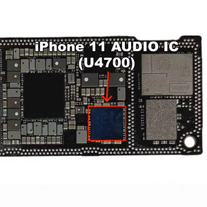

Problem Description
This guide documents an iPhone 11 that was stuck in a bootloop due to a shorted I2C_AOP_SDA line caused by a faulty Audio IC (U4700).
Replacing the Audio IC resolves the short and allows the phone to boot normally.
iPhone 11 - Audio IC (U4700) location on board

  1. Initial Test Connect to DCPS → observe repeated current spikes and drops consistent with bootloop.
  2. Check I²C Lines
    • Measure resistance to ground on I²C_AOP_SDA and I²C_AOP_SCL.
    • Where to measure: The easiest probing point is at the Front Proximity connector (FPC) on the logic board.
    • Expected vs Actual Diode Mode Readings:
      • SDA (Data Line): Normally ~0.342 V. In our case, only 0.060 V, confirming the line was being pulled down/shorted.
      • SCL (Clock Line): ~0.318 V (within normal range).
  3. Isolate Fault Trace confirmed that the I²C_AOP_SDA line runs under U4700 (Audio IC). Remove U4700 → re-measure line → short clears.
  4. Confirm Diagnosis
    iPhone 11 Front prox pins to measure
    Test boot with U4700 removed → phone boots into iOS normally (without audio). This confirms U4700 was the cause of the short.
Repair Steps
  1. Remove U4700 Audio IC.
  2. Clean pads on PCB and prepare a replacement U4700 (new or donor).
  3. Reball or use pre-balled replacement IC, re-install onto board.
  4. Power on and verify I2C_AOP_SDA line is no longer shorted.
  5. Confirm full boot into iOS and test all audio functions (speaker, mic, earpiece).
