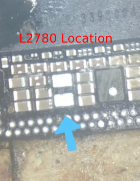

If you have the Apple logo on the right side your issue is likely caused by a faulty coil (L2780) a GPU line (BUCK8_LX0).

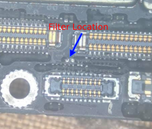

If the Apple logo is in the lower part of the display your issue is most likely caused by a open filter (FL5780) on the line PP1V8_DISPLAY_CONN.

If the Logo in on the right side of the screen we must replace L2780 this is a common issue on the iPhone X, the coil is located on the top board next to the CPU.
- Split the boards using your preferred method.
- Locate and inspect the coil L2780 for any cracks.
- Replace the coil you can get one from a donor motherboard or buy a new one here is the specs 1UH-20%-2.5A-0.052OHM
- Test the motherboard on tool like and Isocket to confirm the issue is fixed.
- Reball the bottom board and solder the boards back together.
If the logo is on the bottom part of the screen like in the image bellow the issue is with the PP1V8_DISPLAY line.
- Locate FL5780 is located near the LCD FPC
- Replace the filter you can grab one from a donor board or buy new one here is the specs: 33-OHM-25%-1500MA.
Note if you dont have a filter on hand you can make a small jumper to test if it fixes the issue.
