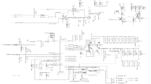

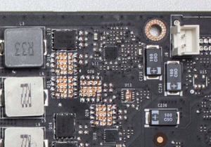

on most Pascal GPUs, the PWM controller responsible for creating and maintaining Vmem voltage is RT8816A by RICHTEK with marking 7J=YM. It is a dual phase controller.
The controller gets its power from 5V rail through 0Ω resistor leading to its 18th pin PVCC.
Enabling this controller is the PGOOD signal from the PEX PWM controller through 0Ω resistors then to a dual MOSFET Q526 which pulls low the signal that is pulling EN low.
PGOOD from this controller is not used for anything.
Markings on the schematic and board could differ from GPU model to another but the circuit is almost always the same.
Vmem PWM controller on the board. (Figure 1)
Vmem schematic view. (Figure 2)
