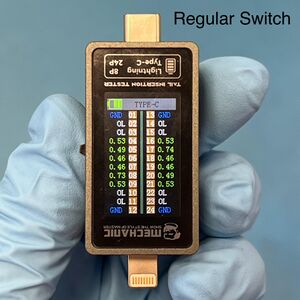

Nintendo Switch Diode Mode Readings from a Mechanic T824 Reader

Inspect the USB-C port for any physical damage, such as bent pins, missing pins, or liquid damage. If you have a Mechanic T284 USB tester, compare your readings with the image on the right.

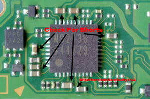

Check for shorts around the M92T36 IC. This chip negotiates power through the USB-C port. Below is an image with capacitors to check.
M92T32 Caps to Check

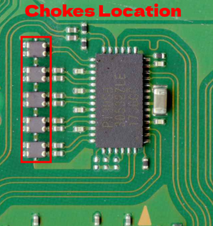

The next area to check is the chokes near the PI3USB IC. The chokes must have continuity in parallel but not in cross.
P13 Chokes Location

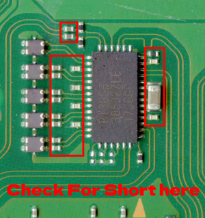

The next component to check is the PI3USB30532 IC. This component is critical for USB-C data switching, including video output via the dock’s HDMI.
P13 Caps that should be checked
In most cases, when the console turns on and charges, the causes for no video output are blown chokes or a faulty PI3USB30532.

The M92T36 and PI3USB30532 are widely available and relatively cheap.
The replacement process is similar for both chips. Use your hot air station to desolder the old chips, clean the old solder, add new solder to the pads, and use your hot air station to solder the IC. Use your soldering iron with a fine tip to touch up any connections that may not be secure.
The chokes are easy to replace. Use your hot air station to desolder them, apply new solder to the board, and solder the new chokes. Be careful not to use excessive air, or you risk the choke flying off.
