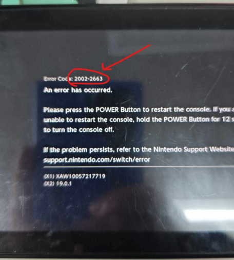

Problem description

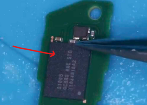

Nintendo Switch that gets error 2002-2663 when you insert the Game Cartridge.
It will boot up fine with no game inside
Symptoms
  • Error 2002-2663
Solution Repair Steps
  1. Try rebooting the game console
  2. Try a new game reader
  3. Try reflowing or reballing IC on the other side of the game cartridge connector
  4. Otherwise, try replacing it
Nintendo Switch Error 2002-2663 IC
