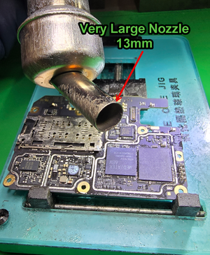

Switch to the largest nozzle your hot air station can support. For the Atten, we are using a bent 13mm nozzle
Large 13mm nozzle for hot air station

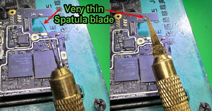

You're also going to need a very thin spatula blade. Use sandpaper to thin it out even further. Ideally, you'll want to taper the tip. This allow the blade to enter under the chip safely & cut through the underfill
Very thin spatula blade
You'll want to use around 380C-400C to heat the chip in a circular motion. Make sure to start off far away, about 6in and heat in circles. This is to first warm up the board.
Over a 30 second period, get closer & closer until you're about 2-4mm away and always keep moving in circles.
Heat the CPU in circles
After about 30 seconds, the board should be very hot. This will make the underfill very soft.
Make sure to keep heating the IC in circles while still in close proximity.
Find an entry point, where there's no components and gently try to pry into the chip. But only go in horizontally. Maybe a little angled to try to get under, but stay as horizontal as possible
If you don't feel it budge, then don't force it in. Although some force is required, there's a fine point on what's too much. This is where lots of practice comes in to know what proper force is
Spatula entering underneath the IC
.As the spatula starts entering, do slicing motions, in and out. But do it gently.
You should be at about 60-90 seconds into this by this point.
If you're not having luck entering under the chip, try turning your temps & air flow up by 10 points and try again.
Don't heat the chip more than 2 or 3 minutes at a time. Reasses the situation & see if you need to adjust your temps more. If your tool is too thick. If maybe there's a better spot to enter.
Whatever you do, do not bend the chip up trying to remove it. You can damage it permamently & lose all chance to get data.

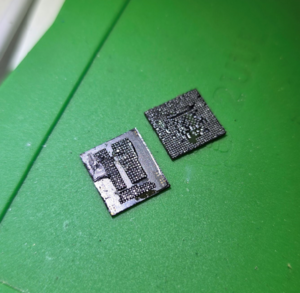

UFS Removed
Once the chip is removed, inspect it for any damage. Look closely for any ripped pads or any scratches on the IC. This is where most go wrong & damage the chip. In many cases, if the chip gets damaged, then it's game over.
CPU and UFS removed
Then you'll have to repeat the same steps to ultimately remove the 2 important chips: CPU and UFS
