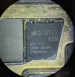

On this model, the CPU is labeled as MediaTek. So we can assume the other chip is the UFS.
Close up of A03s MediaTek CPU

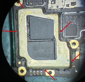

Now we must remove the shield around it to access the chips. I would recommend adding 138C Ultra Low Melt solder to the solder joints where the shield is attached to the board. Make sure to add plenty of flux & use a knife tip style iron
This will make removing the shield much easier
A03s Shield
A03s Shield where you must add flux
Using high temps, like 400C/60 air, heat around the perimeter
Use a hook tool or tweezers to grab onto the shield & pull it up, until it detaches, like this:

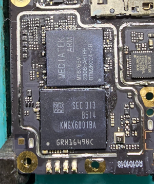

A03s cpu shield removed
And now you have clear access to the 2 chips you need.
A03s CPU & UFS
