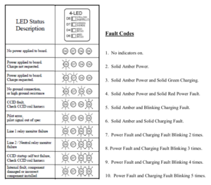

LED fault codes table for HCS series
Clipper Creek HCS user manual (see page 16 for basic LED codes table)
More advanced LED codes come from a table in CC's "HCS Troubleshooting Guide". Note that the number of blinks of the two bottom red LEDs is important. If two blinks, then the line 1 side of the contactor is failing; if three blinks, then line 2.
