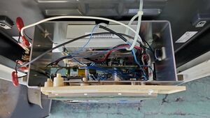

Disassembly to access EVSE internals
  1. Remove two security bolts (Torx security, 4 mm) at top of pedestal.
  2. While lifting LED light assembly up, disconnect the wiring harness, and set the assembly aside.
  3. Remove the two bolts at the top (hex, 10 mm).
  4. At the cable management reel, remove the white cosmetic cover; it pops out with help of a flathead screwdriver.
  5. Remove the two (maybe 3-4) bolts (hex, 10 mm) that hold the reel onto the pedestal. You will need a nut driver for this, since the bolts are recessed in deep holes.
  6. Tilt the large metal cover forward away from the pedestal assembly and lift it away. While you do this, you will need to feed the charging cable back through the grommet. You won't be able to disconnect the cover completely due to the attached cable, but you'll be able to set it aside.
  7. Remove five bolts (hex, 10 mm) that hold the EVSE cover on; these should just be finger tight since they are fastening down plastic.
  8. As you remove the EVSE cover, slowly peel the adhesive gasket off the touch screen.
It's not necessary to access the EVSE internals, but if you want to also remove the pedestal's back cover, use a regular (non-security) Torx T25 wrench. To lift it off the ground mount, you'll need a 1/2-inch box wrench.

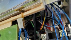

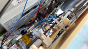

Disable network and touchscreen
aka lobotomize so that it Just Works, simply providing power when you plug in
PE-30 touchscreen assembly
PE-30 touchscreen power disconnected
PE-30 touchscreen data disconnected
