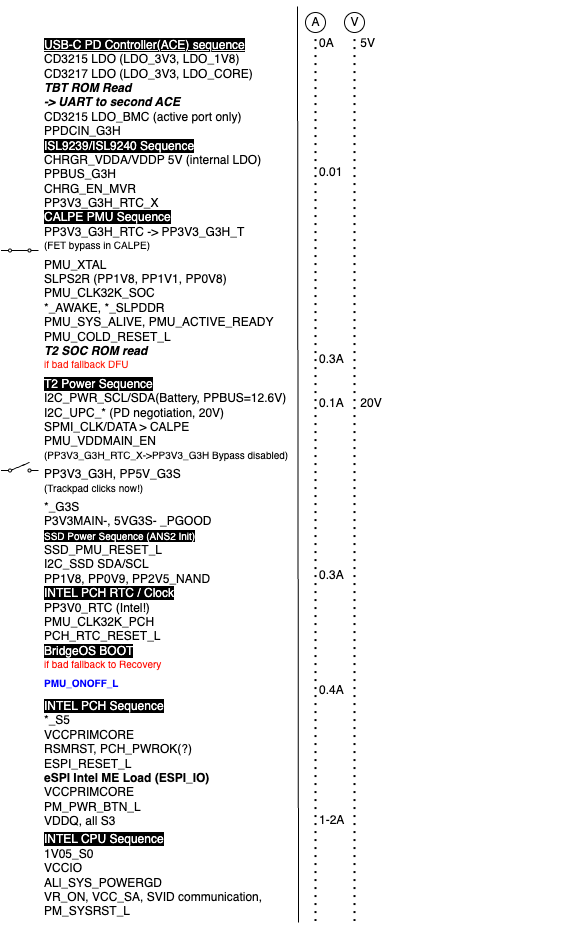

Power Sequence
T2 Platform power sequence is one of the most confusing and difficult parts in MacBook repairs. Being a mixture of iPhone/iPad naming convention and power stages, it is, however, quite simple and much clearer compared to, say, Lenovo's ThinkEngine nightmare.
The power sequence could be possibly divided into 3 main stages:
- "Finite state" stage, which does not require any activity from T2:
- Main G3H power state generators, PPBUS, PP3V3_G3H_RTC.
- T2-Calpe power stage:
- Main T2 power states, "S2R", G3S", "SLP" (not relevant to the Intel platform!),
- Intel Power stage (controlled by PCH/CPU System Agent):
- S5-S0 power sequence is more or less standard for Intel platform, S5 rails are asserted by T2-Calpe, SLP_S3# and above is from PCH
- all sys power good (VR_ON) is also issued by T2
- EFI image is fed to PCH via eSPI interface.
T2 Power diagram
