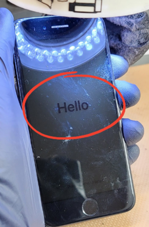

Problem description
How to fix an iPhone 8 or iPhone 8 Plus backlight.
iPhone with no backlight
Symptoms
  • Screen is dark
  • You can see an image but no light coming from screen
  • There's a dark spot on the corner

  • Turn off the phone, then plug in the charger and shine a flashlight on the center of the screen to look for the Apple logo — This helps confirm you are getting image, but no backlight.
