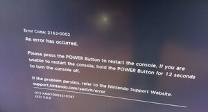

Getting Error Code 2162-0002
Symptoms
  • Error Code 2162-0002
Solution
  • Replace M92T36
