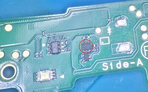

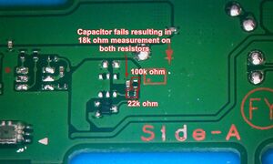

Diagram showing resistor layout

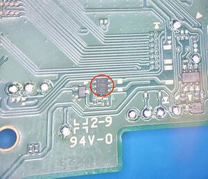

Measure both resistors. 18kohm on both resistors indicates a failed/shorted capacitor (even if the cap does not test as a short). Resistors should measure 100kohm and 22kohm respectively. Measure pin 6 in diode mode-- it should read 0. If it reads 0.6v drop this reinforces the capacitor failure. If resistors check out, the DC-DC component may need replacing
Left Joycon DC-DC converter
Right Joycon DC-DC converter
