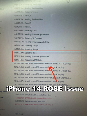

Problem description
iPhone 14 fails to restore and throws Error 9 during iTunes / 3uTools restore. The restore process may begin normally but fails mid-way.
Upon inspecting the restore logs, communication failure is traced to the ROSE IC, confirming a hardware fault.
This issue requires board-level repair and cannot be resolved via software.
iPhone 14 - Restore log pointing to ROSE IC issue

  • Restore logs indicate ROSE communication failure

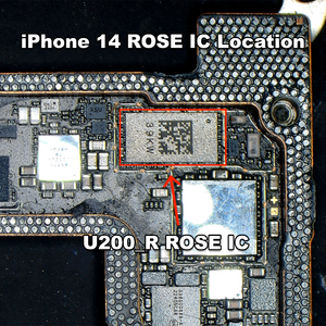

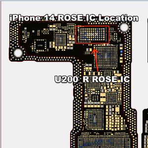

iPhone 14 ROSE IC (U200_R) location on board view
Solution

3. Remove ROSE IC
  • Apply flux
  • Remove faulty ROSE IC using controlled hot air
  • Clean pads thoroughly
  • Inspect for lifted pads or trace damage
4. Replace ROSE IC
  • Install new known-good ROSE IC
  • Align precisely
  • Reflow evenly
  • Inspect solder joints under microscope
