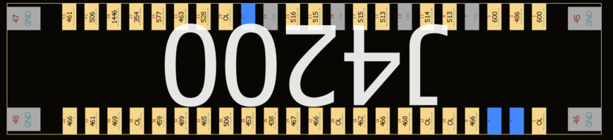

Start by inspecting the FPC connector for any liquid or physical damage.
iPhone 6S LCD FPC
If everything is fine take diode readings of the display FPC and compare them with the image bellow.

When taking diode readings of the FPC, if you measure a line that should read, for example, 0.500V but get 0.100V or 0.000V, it indicates a short on that line. The best way to trace the short is to inject voltage into the line with a DCPS and use a thermal camera to identify which component heats up. Fallow this guide how to find the short Short Circuits - Repair Basics
If you measure a line that should read 0.500V but get OL (Open Line), it indicates a disconnection in the circuit. To trace the issue, consult the board view to follow the line’s path.
