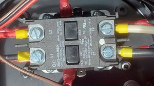

Hongfa contactor seen in actual unit
Two of the fault codes above involve a failed contactor, one of the few mechanical items in the assembly and thus more prone to failure. This part is a 40-Amp, 2-pole contactor with metal mounting plate and screw terminal capability. When terminating wires into it, crimp ferrules onto the wire ends.
contactors for HCS series
Make Model link link suitability
Hongfa XMC0-402.IBBD website contactors catalog (PDF) used by OEM
American Zettler XMC0-402.IBBx (x=C? D?) unknown
Homer XMC0-402.IBBx (x=C? D?) unknown
Packard C240C unknown

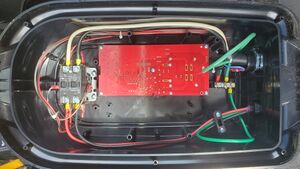

inside view of HCS series EVSe, with back cover removed

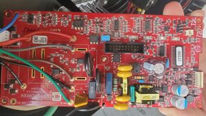

lone PCBA inside the HCS series EVSE
