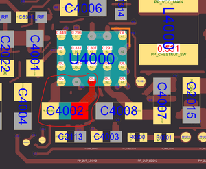

A somewhat common issue is having C4002 shorted. To check this, set your multimeter to continuity mode and place a probe on each side of the capacitor. It should ''not'' show continuity. | |||
[[File:C4002 iPhone 6S.png|center|thumb]] | |||

A somewhat common issue is having C4002 shorted. To check this, set your multimeter to continuity mode and place a probe on each side of the capacitor. It should not show continuity.
