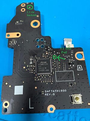

Damaged signal pad
In case the signal pads on the pcb get damaged (See Figure 1):
On each controller board the leftmost and rightmost pin of the switch is connected to the ground plane of the board.
Test point of the L1 shoulder switch on the rev B controller board
Figure 3: Test point of the L1 shoulder switch on the rev B controller board. red circle: testing point for the L1 switch.
The middle pin is connected to the MCU/a signal multiplexer. On the left controller board you can strip the solder mask of the trace, running to the middle pin of the switch or connect the middle pin of the switch to the corresponding testing point for the L1 switch (see figure 2 and 3 on rev. B boards, figure 7 on rev. F board, figure 8 on rev. G board).

Testing point for L1 switch on controller board rev. F - left
Figure 7: Testing point for L1 switch on controller board rev. F - left
Figure 8: Testing point for L1 switch on controller board rev. G - left
