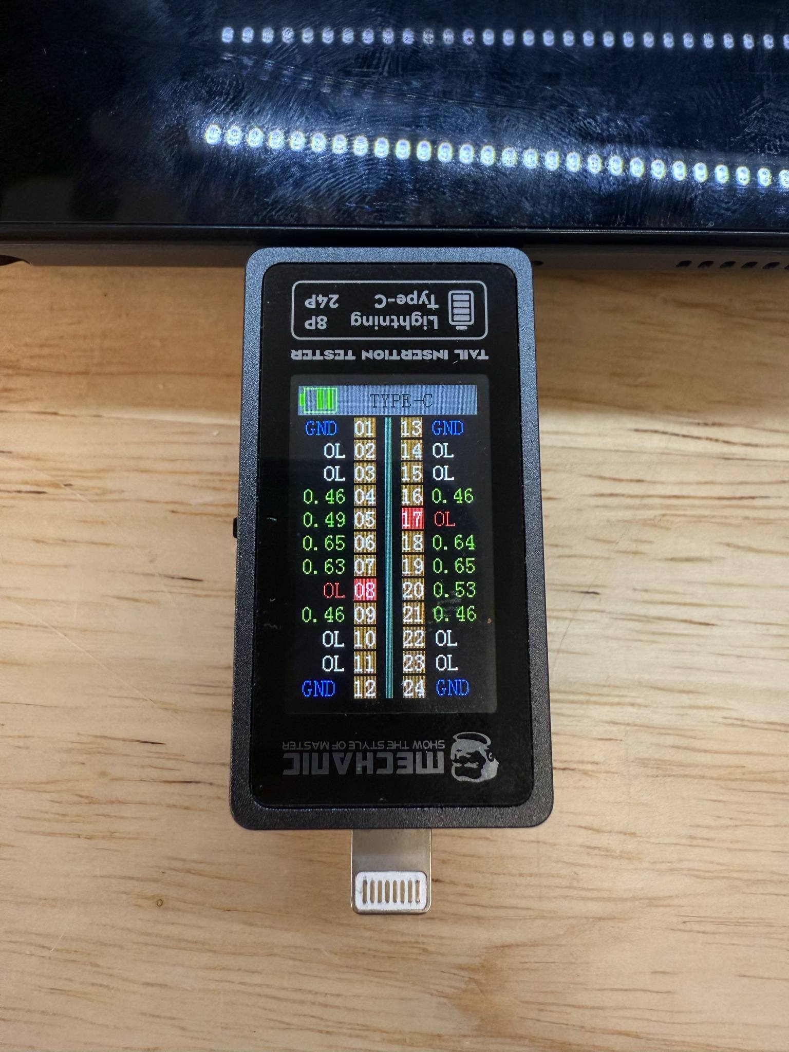

If every thing is ok the next thing to do is with a Mechanic T-824 take diode readings of the USB port.
Note: It is normal for pins 08 and 17 to be OL since this device doesnt have Video output the P13 IC is not present.
