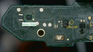

The Nintendo Switch motherboard has some capacitors commonly referred to as "CPU capacitors" which when shorted are (or can be) an indicator that the CPU itself is dead.
HAC-001 and HAC-001(-01)
M92T36
M92T36 has a capacitor next to it which when shorted is very commonly associated with a dead CPU.
SOT-323-6 IC near MAX17050
This IC has a capacitor next to it which when shorted can indicate a dead CPU
