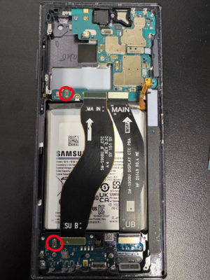

  • Visually check the device
  • Try with known good Dock Assembly

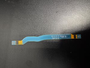

  • Try with known good GSM antenna(shown in the picture below)
GSM ANTENNA

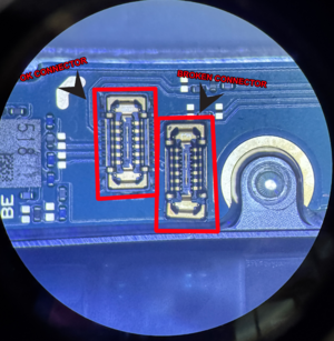

  • Carefully check the top and bottom connectors of gsm antenna, Sometimes they don't look broken, if you have any doubt on a connector just replace it, see the pic for reference below.
CONNECTOR COMPARISON
