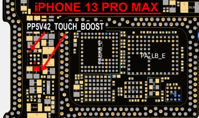

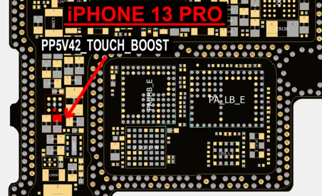

The problem generally is due to a faulty capacitor that is placed on the touch boost line. Replacing the capacitor C8901and (8903 only in iPhone 13 pro max)(according to JC Drawing) fixes the issue.
13P FAULTY CAP
13PM FAULTY CAPS

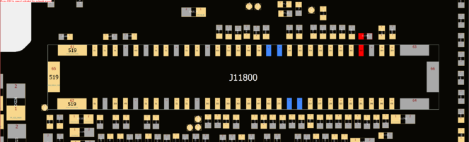

  1. Check diode values on the connector, if you see any unusual reading trace it or else continue to the next step if all diode values are good.
    Diode value

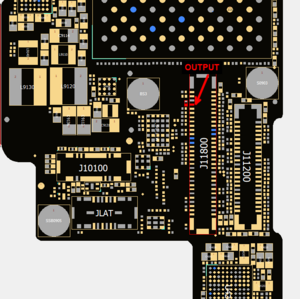

      • Check the output voltage on pin #54(according to JC DRAWING)
        Output of Display Boost IC
      • If you get no voltage output then proceed to the repair steps

  2. Check the capacitor C8901+(C8903 only in 13 pro max), if shorted it MUST be replaced.
NOTE: (if you don't replace this capacitor phone will still have no touch problem)
Faulty Cap
Faulty Caps
