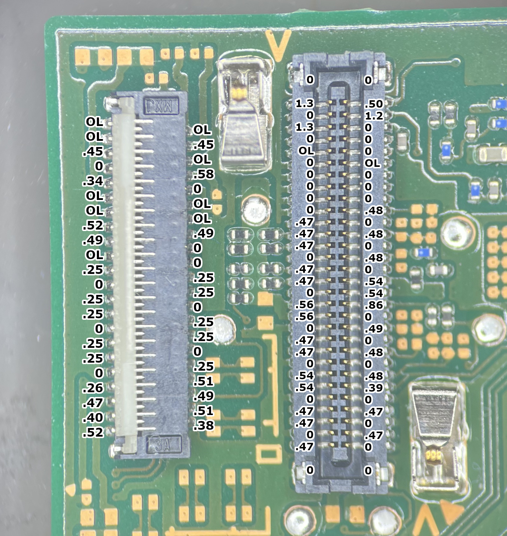

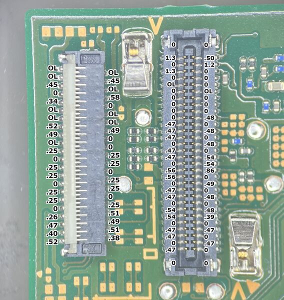

Diode mode measurements of the display connector and game cartridge reader connector on the Switch OLED
current01:36, 19 June 2025Thumbnail for version as of 01:36, 19 June 20251,716 × 1,812 (921 KB)KevinShort (talk | contribs)Diode mode measurements of the display connector and game cartridge reader connector on the Switch OLED
